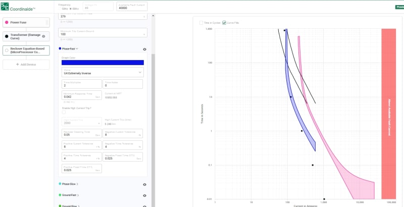

Single feeder substation, 69kv 5/6.25MVA transformer. Outgoing 13.8kv feeder loaded at 303 amps. Setting the feeder pickup at 200% as done normally results on a grossly oversized primary fuse.

Alright, a quick test:
It works with a 100E fuse, however, that seems grossly over sized being only a 5/6.25MVA trafo. Will it even protect the trafo for a fault between the secondary and station re-closer?
I'm keeping keeping the curves further apart then they need to be (at first glance) due to the delta wye per unit current discrepancy during a phase-phase fault not involving ground.
