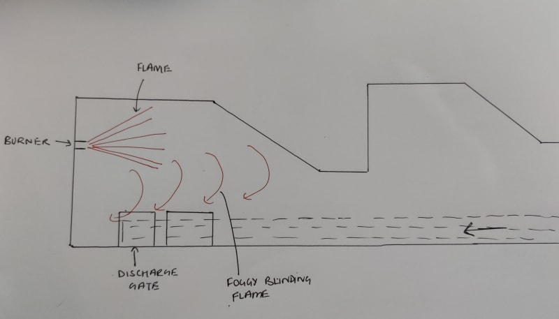

Currently I'm involved in a steel Re-heating continuous furnace project for heating billet , scraps. It's pulverized Coal fired having two zones - soaking and heating zones.
Secondary air of soaking zone burner is preheated (recovered heat from Draft)
The problem is that whenever coal concentration is increased in the primary air, excessive fumes starts forming (I don't know if fumes is the right word.. Maybe it's POC. its between flame and fumes.)
These fumes are so problematic that it blinds the workers which unable them to perform the job.
Reducing the coal concentration partially solves the blinding problem but after sometimes it leads to a large decrease in the required temperature in the soaking zone. Halting the flow.

Furnaces require some percentage of excess air depending on load to prevent smoke
I have tried changing the excess air but still no results. Actually it isn't smoke, maybe it's an extension to the flame as you can see in the figure given below( Sorry for bad drawing). What is more troubling is why these foggy Fumes/POCs are moving in the opposite direction??

I have checked the manual, there isn't thing like this but most of the burner related problem are due to coal flow. Could this be the problem??
I'm using volumetric screw feeder, maybe it's giving somewhat pulsating coal fuel? Could this be the issue??

I have tried changing the primary air/fuel ratio but I didn't get any promising results. But those Fumes/Flame/Fog tends to reduce when the primary air supply is decreased but it lead to choking of primary air. Secondary air has no effect on this.
