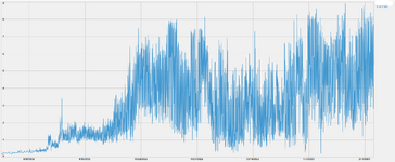

Below is the DP plot of the system. We changed the filters in August of last year and the DP increased until it was around a max of 9. The filters are supposed to have a burst rating of 32 psi, so we were nowhere close to that. I have also attached the filter literature as well. The liquid gets removed and then pumped down once it hits a certain level. From what I have been told we have never even come close to the max flow rate of the vessel.

Following-up, other aspects such as temperature and pressure/flow spikes may still be applicable, I thought you might be interested in the graph illustrating rate of clogging. Pressure drop increases exponentially, thus it doubles at 50% clogged and doubles again at 75% clogged etc... Therefore if there is a sudden load applied to the filter media it can 4x to 10x the DP extremely quickly. I suggest having a failed cartridge analyzed by Pall; they should be able to hypothesize on the root cause of failure which may help you determine which aspect of your process to review.

That's quite an extraordinary variance in differential pressure.
After 5 months of that the filter probably fatigued out.

I agree. It doesn't seem like there should be that much variation in DP across the filters, especially after such a short period. Can fatigue cause the filter to fail?

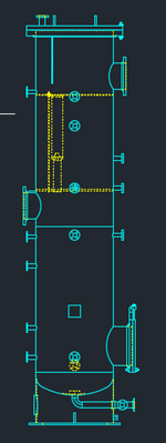

Is this what you have?
That looks to me like there are two liquid sumps. A knock out pot at the base and then a liquid pot in the main coalescing section.
Do you have a sectional drawing or P&ID of this?

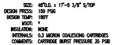

Do you have the specicif data sheet for these as it says burst pressure etc is customer specific.
a margin of 3 or 4 to the burst pressure for max DP seems to be common, so your 8 psi is pushing the boundaries. IMHO.
Maybe try reducing the height at which it pumps out both pots. The base pot may just be picking up slugs if it gets too full and the top pot adds to the DP.
Does the DP variance respond to liquid load?
These coalescers look fairly thick and have complex fibres so rapid changes in flow velocity or liquid load will induce flexing and lead to fatigue damage.

Yes, this is exactly what we have. And yep, the flow does go from bottom to top.
You do have me intrigued on the slug idea though. Help me think through that please. What would cause a slug to be formed and travel to the filters?
I have attached the documentation I have on the coalescer below.

You should have dedicated upper and lower sumps, each with its own level control and liquid exit to the downstream collection header. Can we see the PID for this ?
A slug can form in any section which has a low spot or an overflow from a downstream piece of kit.
in this case it is more about a sudden increase in liquid droplet density causing a shock to the material on a regular basis.
Also if your levels are too high then some of the liquid or maybe even foam can get swept up with the gas.
but as said before you tend to look at a FOS of 3 to 4 for filter coalescers like this so 9 psi is about the point where they could need changing and not being run like that for 4 1/2 months.
