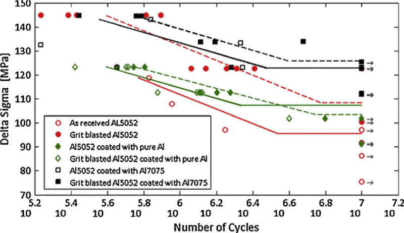

Hello there,
I am trying to find Wohlers curves or S-N curves for aluminum 5052. More specifically I want to calculate the fatigue life of a component made from this material with the Miners law but I cannot find fatigue information about the material.
Any help would be appreciated.
Thank you.
Will this help:
Note that the above graph was taken from this item:

My structure has very thin walls. So the data must ideally be from foil of a piece with thick < 1 mm. I cannot seem to find this data. I will check want you provided though.
Thank you a lot!

Yup, that’s what an S-N curve looks like, but it really tells you so little. See where that research came from, what the samples looked like, and what the testing methods were, etc., and it gives you a bit of info. about the bulk material properties. And, you can compare the Al 5052 with other basic materials, and that’s about all. With thin material you problem might as likely be out of plane flutter or vibration causing high stresses at connections or stiffened locations. Your problem probably has as much to do with the product shape or geometry at the critical locations, the bonding methods, manufacturing methods, quality control, etc. Study these in detail at each of the failing locations and see what you can improve. What, of many things, other than base material could be causing stress raisers, concentrations of vibration, maybe bond joint size and shape and stiffness immediately around the joint, etc. Many times, it isn’t the base metal which is the problem, but rather our design, shape and detail which is the killer.

If I want to find S-N curve for the material al 5052, where should I look?
Didn't I already provide you an S-N graph showing the curves for AL-5052 based on various types of finishes? I also supplied a link to the source document where that graph was found. What else are you looking for? BTW, I used Google to find what I did. Have you spent any time Googling for the information that you're looking for?
