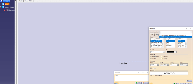

I had found a problem, i have to change a text that is inside a ditto. But the ditto could not be exploded, how could i find the text in that case?
Let's change the approach... if i have this "path" that is generated by a detail Modifiable in instance that was created with instantiate 2d component. How can i edit the text inside? Since the search query is not finding the instantiated items i cannot use the
selection3.Item(1).Value.Text = "Text2"
Any suggestion?
I would expect something like
Text.2/2D Component[2]/Background View = "some other text"
Search the V5Automation.chm Help file in your CATIA Installation path for DrawingComponent. It has a method called GetModifiableObject() the will retrieve the Modifiable objects in the 2dComponent.
