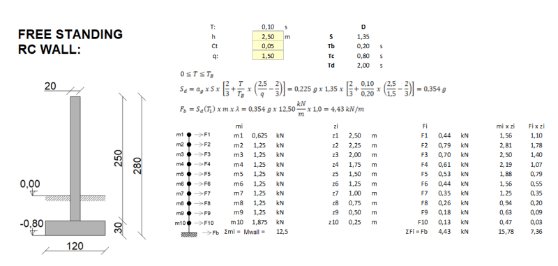

Hello,
Is this a proper way to do the seismic calculation for free standing wall?
(based on Eurocode standards)
thx for replies.
It is very hard to make comment without named variables or the spreadsheet.
What is will say is generally you need to calc your period/frequency.
