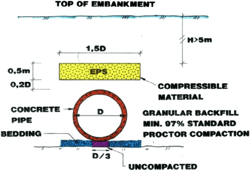

Hey, do some research on the subject of "imperfect trench" by two old long dead engineers in Iowa. Spangler and (forgot name). This trench was invented by them to allow placing higher earth loads on a fill with a pipe only suitable for low loading. What it is is the zone above the pipe has old fill removed and it is substituted by leaves or straw. The soil on ether side of the trench loose covering then takes over the loading of the added fill above.
When I was the chief soil engineer for Wisconsin DOT back about 1960 there was a sanitary sewer discharge from the Eau Claire city sewage plant going under a roadway. That pipe could not be shut down for any replacement,. Fill to be added above it for the new Interstate was maybe 20 more feet (not exactly sure of this number) so the Imperfect Trench was used and my bet is that discharge pipe still is in use today.
There's also elastic EPS available, which we've used as a compressible inclusion to limit passive soil pressures due to structures moving against soil. We used it in a horizontal application, but it might work in a vertical application, as well. As of the last time I looked, Terraflex was the only product of this type still available.
I also found this paper on the use of standard EPS geofoam for protection of buried pipes.

I think the benefit of replacing soil with EPS is the reduced overburden. That way adding a surcharge load can be offset by the reduction in overburden. But on the other hand you lose the beneficial arching/load-spread action of soil. With EPS fill over the pipe, the footing load would transmit directly to the pipe without much attenuation. It's lightweight but doesn't create a "void", in a structural sense.

Found a good paper with in-situ test results:
The NPRA has instrumented 4 locations and monitored the reduction in vertical stress (Vaslestad et al., 2011). These studies show that the long-term measured vertical pressure above the crown of the pipe ranged from 23 to 25% of the overburden pressure for installations with granular backfill material, and about 45% for installations with cohesive soil backfill. It was found that the performance of the induced arch was largely affected by the type of soil used in the embankment construction. Field installations with granular fill reduced the vertical pressure over the culvert more than those with silty-clay embankment. Nonetheless, the measured earth pressure for the section of culvert without the induced trench installation showed pressure that was 124% of the calculated overburden pressure. The final compression of the EPS geofoam block at the end of embankment construction ranged from 27% to 32% for concrete pipes with granular fill, and 50% for cast-in-situ box culvert with cohesive fill.
Edit: This was the setup for the above results. A geofoam version of the Imperfect Trench.
Imperfect-trench-method-with-EPS-geofoam-compressible-inclusion-placed-atop-concrete_vecbga.png
