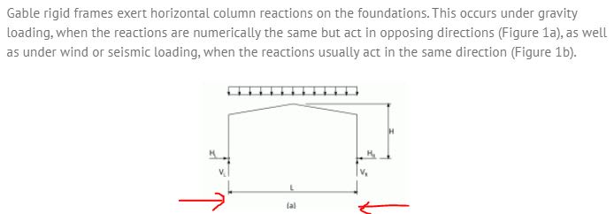

Can someone explain the concept of gale rigid frames exerting horizontal column reactions on the foundations in the same direction ? How do I calculate these values ?
If you can picture a simple beam with a loading on it, the ends of the beam want to rotate. This rotation is transferred to the supporting 'legs' of the rigid frame. The rotation wants to force the bottom ot the legs outwards. A horizontal reaction is required to 'force' the bottom of the legs back into their original position.
Cut a metal coat hanger and bend it to look like your frame.
Squash it a little like your load does and both leg bases will move outward.
You will have to push the bases back into place with your fingers applying forces similar to the red arrows in your diagram.
1503... a better example, thanks.
Thanks for the example , they make it very clear. So if I have to hand calculate those forces , how do I do that ? If I consider moment about any random point, the moments due to the horizontal forces will always be zero , so I am clueless as to how to calculate those horizontal forces ?
You have to use a computer program, or moment distribution to determine the moments and then back calc the reactions.

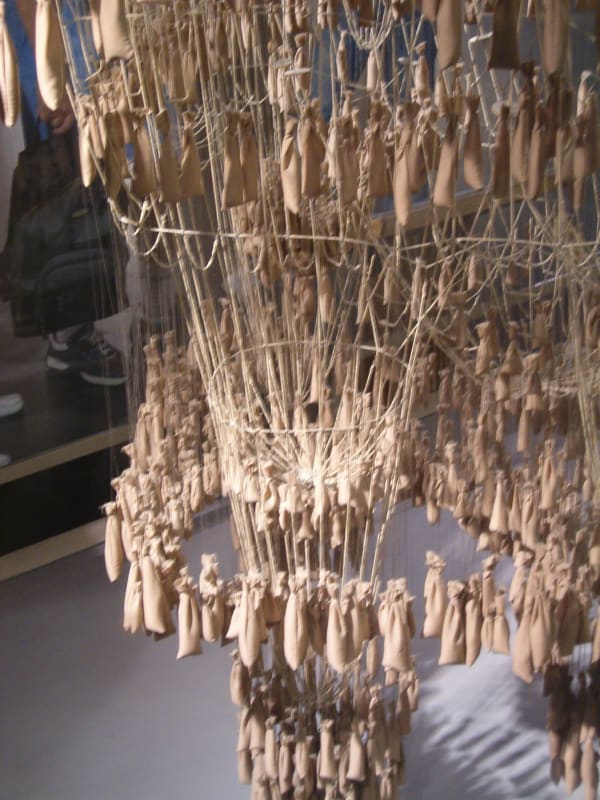

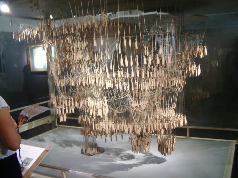

Gaudi designed the Sacred Family Cathedral in Barcelona for compressive loads using an inverted tension model of the structure made with strings with appropriately sized sand bags located at all steples and arch intersections. The model still hangs in his design workshop in the basement. Add sand until all bags hang straight down. Multiply all forces by -1.
