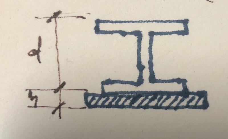

We have old steel elements that need to be enhanced with a steel plate on the bottom to support new equipment in an old building. We consider welding a plate on the bottom. When it comes to NA, new Ix, Iy, rx, ry etc, that's easy pasy. I am stuck with which formulae would be applicable for the J (torsional constant) and the rts. The AISC 15th edition manual is giving us something on pg. 161-49 but I am reluctant to use that as we don't actually have a symmetrical element since the bottom flange is going to be way thicker now. For J, again, the top and bottom flanges are not identical, so is there a formula that would be applicable?.
To get an accurate answer you really have to resort to FEA to work out torsion and warping constants. I recommend this python package if you're after a free open source means of doing this, if you're familiar with python of course (but if you check the read the docs page there are plenty of examples to get you started). If you provide the dimensions I'm even happy to provide a script to get you started.
I have seen a simple formulation somewhere but can't recall where (in relation to adding channels to top of I-sections for crane runway beams and estimating the resultant J), whereby you simply equate the flange and strengthening element to an equivalent thickness single plate and do the old J = sum(bt^3)/3 for an open section for all the plates making up the I section including the strengthening plate. Obviously, this type of simple formulation negates the benefit of the root radii which can actually add a lot to the torsion constant in I-sections.
