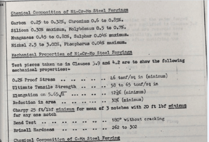

Hello,
Could you help us to find out our seperator material related specifications? It can be seen below chemical composition.
DIN 40NiMoCr10 4 is a specifications that i could find closest specifications.
Is there any welding recommendations for this material?
Best Regards,
This looks a little like a 48xx steel.
Is it real thick?
These steels are usually used either for very t hick parts or for low temp service.
