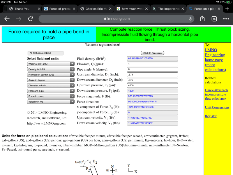

The minus sign is because the formula is calculating the force required to oppose the force on the pipe. Let’s look at the case, where the cross-sectional area is not changed. Then, it would appear, P₁ = P₂, and A₁ = A₂, V₁ = V₂. Then Fx = - 2PA - 2dQV.
For the scenario we are considering the pressure is high, but the speed V of the flow is low. Then the calculated force would be approx. Fx = -2PA, i.e., the force by the water on the pipe is Fx = 2PA.
The problem is this would be much larger than the water rocket formula since it uses the full cross-sectional area of the pipe, not just that of the nozzle.

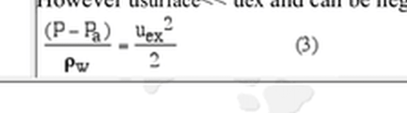

Here is the water bottle rocket analysis for one pressure washer:
We’ll use the first equation shown there which amounts to F = (mass flow rate)*(exit velocity). Take for example this pressure washer:
PowerShot PS4240 4200 PSI at 4.0 GPM Cold Water Gas Pressure Washer with HONDA GX390.
It can do 4,200 PSI at 4 GPM with a hose at 3/8 inch inner diameter. We’ll convert to metric to have consistent units. A gallon is 3.78 liters so 4 GPM, is 15.12 liters per minute which for water means 15.12 kg per minute or 0.25 kg/s.
For the exit speed, we’ll use the last formula given there,
(P - Pa)/ρw = uex2/2.
Now 4,200psi is 4,200/14.7 = 286 bar = 286E5 Pascals.
Then uex2 = 2*286E5/1000 = 57,000, and uex = 240 m/s.
So the force would be 0.25 * 240 = 60 N, or 6 kg-force, about 12 pounds.

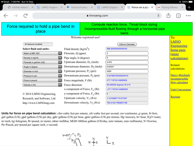

On the other hand, let’s see what the answer would be using the online calculator:
Robert Clark
...And here is the answer using the online calculator at the link:
We'll restrict the diameter at after the bend to make the scenario like the water bottle rocket case. I was surprised to see that the force was still much higher than the water bottle rocket case:
The force calculates out to be 477 pounds! This compared to the ca. 12 pounds you get from the water bottle rocket analysis.
Note the exit gauge pressure is approx. 0, i.e., relative to that of ambient air, and the flow speed is greatly increased. Like in the water bottle rocket. Yet the force is still much higher. This now is a real discrepancy.
So which is the right answer?

The only obvious difference between the two cases is that the water bottle rocket case exits out to the open air, while in the force on a pipe bend case it remains inside the pipe. I thought I was taking that into account though in the pipe bend analysis by restricting the pipe diameter down just like a nozzle for the water bottle rocket. Note the pressure after the pipe bend does indeed equal ambient air pressure, like with the water bottle rocket exit flow, and the flow speed after the pipe bend also equals the exit speed for the water bottle rocket. (The online calculator for the pipe bend gives the speed in ft/s but it equals the speed for the water bottle rocket given in m/s.)
If the difference really is just that one exits out to the open air, then if we have a pressure washer and just put a bend in the hose with a restricted hose diameter then it would experience such a high force on the bend. That doesn’t seem reasonable since such pressure washers are in common use.
Well, perhaps the answer is that we are restricting the diameter in the pipe bend case and that is why the calculated force is so high. But actually if we don’t restrict the pipe or hose diameter then the force is even higher on the bend! See the attached calculation. If we keep the same pipe diameter after the bend the force on the bend is 928 pounds!

Surely with b = 0 you have a U bend?
This looks nothing like the rocket which is all in a straight line so the angle would be 180 degrees in your online form?

The pipeline thrust block analysis is not rocket science. The problem is the FBD, free body diagrams you have imagined are not the same for rocket's and pipeline bends. Well, not usually anyways. Along with setting the bend angle error that LittleInch mentioned, the 4200psi x area is an external force applied to a pipeline bend free body diagram, however that force would not be present on a free body diagram of a rocket, because the 4200psi remains wholely contained inside the rocket's tank. The rocket free body diagram would only use the downstream half of the pipe calculation, exit pressure x the area of the nozzle. There is no 4200psi x area of the 0.375" diameter pipe that would cause or resist the motion of the rocket. That's just an internal tank pressure.
In pipeline work, P x A are large forces and m/2g V^2 are usually very much smaller. For rocket work it is the exact opposite, P x A is very small and the m/2g V^2 is huge. Aerodynamic drag replaces the 4200psi x Area. In fact, many thrust block calculations you see on the Internet do not even take the change of momentum into consideration! They assume V is small enough to completely ignore. That's usually true enough, because they are not high velocity pressure washers. High velocities in pipelines cost too much money. Those calculations use only the P x (A1 sin Ø - Ao) to calculate forces on a bend.
A rocket Bernoulli equation would have 4200 psi acting down on the water surface, not 0, and there would also be a top of the tank, and sides, all having the same, counteracting 4200 psi pressure acting up. Net zero, up, down, left and right. No motion caused, no motion resisted. No P, only Pa x Ugx.

For your purposes forget the bend calculation.
What you're calculating there is really just end cap force.
Pressure washer tubing is actually really quite strong in an axial sense as it has to resist this force when operating and you release the trigger.
