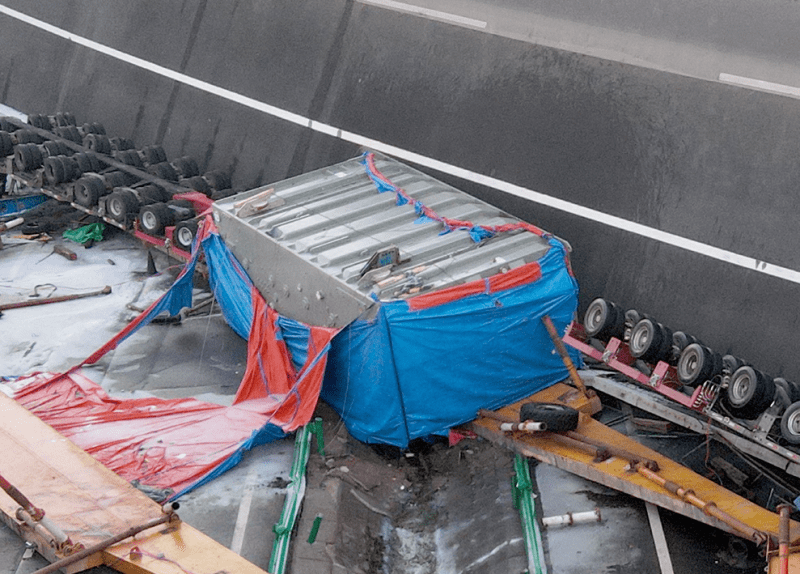

"Four people died and eight were injured after a section of a highway flyover in China’s central Hubei province collapsed, according to Chinese authorities."
Looks like some kind of heavy load platform caused the section of bridge to overturn. The structure itself appears to be in surprisingly good shape.
I would be interested to know what the platform was carrying and how heavy it was.
Does anyone know if bridges in China are designed for these sorts of vehicles, and whether there are any restrictions on lane position as there are in other parts of the world (e.g. Australia)?

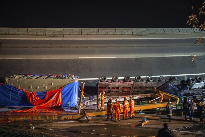

A couple of clearer pictures of the payload.
Maybe some kind of electrical equipment?
Looks like SPMTs carrying something. The heads on those columns look a bit small.

Many wheels/axles on the trailers, probably intended to distribute the load longitudinally, but that was never going to happen. The single column intermediate supports didn't help, especially on a horizontal curve. And there doesn't appear to be anything at the end supports to prevent rotation.

There would have (or should have) been a pair of bearings at the end piers, which would provide rotation restraint to the bridge section.
Seems like it wasn't enough to prevent one side lifting up.
Was the load platform right along the edge of the bridge? In Australia these things have to drive along the CL of the carriageway +/- 1 m.
Maybe the bearings were only for gravity loading, not uplift?

That seems to be the reason for the failure in my opinion. In my (limited) experience it is not common for bearings to be specifically designed to resist uplift, though it can be done. And even where uplift tends to occur, there can be easier way to avoid it, e.g. by adding ballast to certain parts of the superstructure, mandating particular positions for very heavy vehicles such as this one, etc.
My bet is that the load platform / SPMT was driving close to the barrier on the outside of the curve for some reason.
"The newspaper Beijing News said the truck (198t) was four times over the allowable weight limit on the flyover..." The load has a little extra leverage on the outside of the curve too, of course. Can we put this one down to operator error?
The extra long SPMT isn't really help to reduce the load per axle as the overweight equipment was concentrated in a small section. It's an operation error in combination with the engineer and maintenance mistakes.
Those orange pieces are a bridge section that spans between the two ends to spread the load out. See typical rig here: In the US, anything over the normal weight limit requires permits from the state (and perhaps local) highway departments. I have no idea how things work in China.
