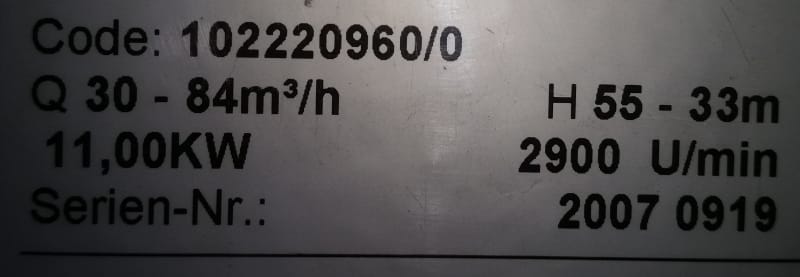

1. The attached link shows the picture of pump spec as seen on the pump body
However, the pump curves and other details are unavailable (not received from the manufacturer).
Now the picture shows a specified flow rate of 30-80M3/h, unfortunately the facility is currently operating this pump between 20-35m3/h. Is it safe to say the pump is underutilized and not working within its best optimum points. Can you deduce from this that the pump is probably experiencing cavitation because it is working below its specified range?
2. Can you explain further your suggestion in your previous response about maintaining constant flow with a centrifugal pump by use of valves.
3. Are there any external signs of cavitation?
You have two points on the pump curve. 30 m^3/hr at 55 mh and 84 m^3/hr at 33 mh.
Ted
I initially read that as 11MW, but it's the continental way of writing 11.00
Yes at an operating range below the range specified the pump is essentially too big and won't be operating efficiently, but will be using less power than at higher flows because it isn't doing the same amount of work.
It shouldn't be cavitating though unless other things are happening on the suction side as you're not giving us any real information here.
