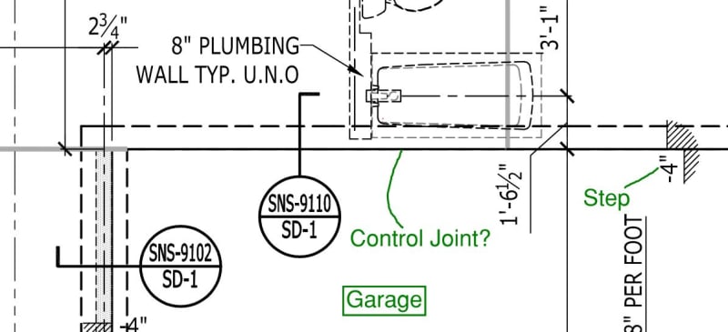

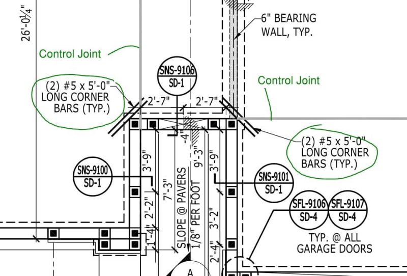

For Florida Residential Buildings(1 and 2 Story houses):
1- Do you guys put corner bars intersecting Slab Control Joints at corners? Or we should only use one of the two, either control joint or corner bar, because one defeats the purpose of having the other.
See Snip below
2- Do you guys add a Slab Control Joint at the transition between Garage step and the rest of the house?
See Snip below
