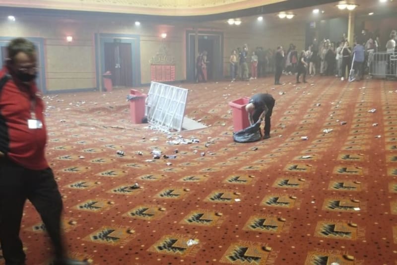

This could have been a complete catastrophe. A section of dance floor at Enmore theatre in Sydney collapses under the weight of dozens of people dancing. The carpet spanning across the hole appears to have kept everyone from falling through to the 4 m (12 ft) void beneath. No injuries recorded.
The building dates to 1908 and is a well-known music venue in Sydney.

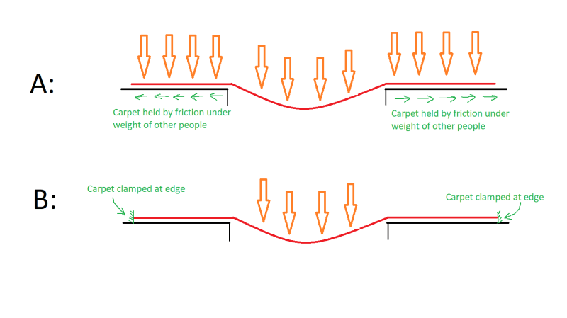

The videos show people walking above where the collapse occurred, seemingly supported only by the carpet.
Obviously the carpet wasn't actually holding anything up since the floor sagged and didn't actually collapse.
It's impressive the floor can be flexed that much and no-one believes there is any residual damage that is of concern. Just jack it back up and stick new supports under it.
