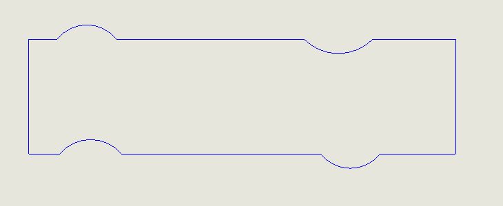

Here is how i approach it:
1. First i draw a rectangle of perfect form, at the maximum width 15.04, uniform along it's full length.
2. I add a local bulge on the bottom surface at maximum height allowed by it's flatness control - .005. To compensate for it and maintain the maximum local size, the top surface needs an opposite cavity, also of depth .005. So far the envelope is is 15.04+.005=15.045.
3. Now i add a bulge on the top surface. Since i know that the bottom surface will need to compensate for it with a cavity limited by it's flatness, i can only add a bulge of .005 height. The resulting final envelope is: 15.04+.005+.005 = 15.05.
I may be wrong there, but that is my current line of thought.
semiond,
You had me till #3. It seems to me at #2 you were at .005 form error top and bottom already then when you moved to #3 you added another .005 to each surface which would be .010 form error at both the top and bottom surfaces, which violates the tolerance applied.
Chezz311, #2 and #3 are at different local sections (i shouls have emphasized that). Local size limits are not violated.
I figured you weren't violating local size - its the form error that is exceeded. I assume you mean a shape like the below? Even still - if you go .005 in one direction and .005 in the other on the same surface you're still at .010 total which is outside the allowed form tolerance.
You are right,
I stand corrected.
After #2, there is no possibility to add a cavity on the bottom surface. Which means the maximum envelope is 15.045, like you said [thumbsup2]

Looks like flatness within .008 has no influence on the extreme bounday BOUNDARY.
Should we assume that the smallest value for flatness is the one used to be added to the maximum thickness regardless of the size tolerance value of the plate thickness ?
In other words if the thickness would be 15 +.0004, -.0002 the maximum envelope calculation / extreme boundary stays the same: 15 + 0.0004 + 0.005 (again just the calculation concept, not the result)?
greenimi,
I think I understand what you're asking. Basically you're wondering even if the form tolerance is larger than the size tolerance if the maximum envelope is still dictated by the smallest form tolerance in this case - right? The answer would be yes.
Think about it this way - no matter the size tolerance applied, if the note "perfect form at MMC not required" is included on a feature with no form tolerance applied the maximum envelope is now technically infinite, right? And even though size tolerances have to be finite (obviously - just a thought experiment here) they have no effect on the allowable form error and do nothing to limit the maximum envelope when no form tolerance is applied. So any form tolerance applied, even if greater than the size tolerance, will limit that maximum envelope proportional to the smallest form tolerance applied to the feature. In this case I think the question was worded the way it was to trick us into thinking the .008 tolerance on the top surface changed the maximum envelope vs. the .005 tolerance on the bottom surface even though it is the smallest form tolerance that limits this envelope.
