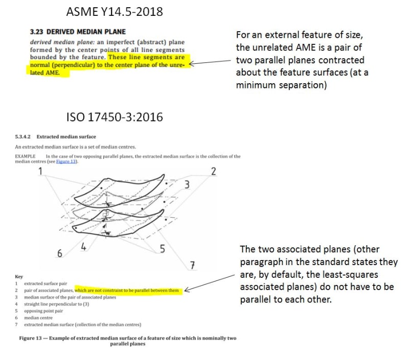

MaxSka9,
DMP flatness is not the same in ISO and ASME. The difference is in the way the median plane is established from the as-produced geometry. It's not a big difference but it exists.
@pmarc Well haha I stand corrected then. Could you give an example of how they might differ?
I understand the difference between ISO and ASME when rule 1 is applied when it comes to extracting planes or axis from surfaces and features of size
But doesn’t flatness of a derived median plane nullify/override rule 1 anyways?
I ways mainly happy I was right in that it was even possible in ISO at all haha.
I am curious too about the subtle differences.....
Thank you pmarc
MaxSka9, greenimi,
The illustration below is aiming to show the difference. First difference is in naming - Derived Median Plane in ASME vs. Extracted Median Surface in ISO. Let me know if it helps.
To answer the other question: "But doesn’t flatness of a derived median plane nullify/override rule 1 anyways?"
Yes, in ASME the DMP flatness always overrides Rule #1 and so if one wants to control the DMP flatness within Rule#1 an additional trick needs to be used to accomplish that.
It occurs to me that it's not the Unrelated Actual Mating Envelope as that cannot be determined until the feature is brought into contact with the Actual mating parts.
It's a Theoretical Unrelated Mating Envelope which is a stand-in. TUME.
Wait.
It's an Approximated Theoretical Unrelated Mating Envelope because of imperfections in the inspection equipment - ATUME!
The question I have is this - what function is used in any FEA program to understand the behavior of the part based on the derived median plane (hmm, it's not planar) or extracted median surface (score one for ISO making a sensible term, but they apply it to a plane that they call a surface)?
Since this is a critical control with a lot of thought put into details of how to measure it, there must be examples showing real-world implications.
pmarc said:
...so if one wants to control the DMP flatness within Rule#1 an additional trick needs to be used to accomplish that....
pmarc,
flatness |0 MMC|
flatness | tolerance|
I think I learn it from you (pmarc) and since my memory is not that great, I am asking you, again, if it is correct or I missunderstood you?
greenimi,
Yes, you remembered that well.
