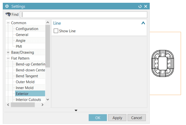

Hi Christian,
my ideas to let Flat Pattern disappear (on purpose):
1) Double click on the border of FP view (Settings) and unselect the FP lines.
2) Or Ctrl+W and Hide All
