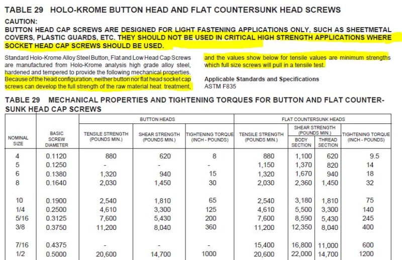

Can anyone recommend a type of high strength Fu > 60ksi, with a flat head that can be countersunk Bolt size is 1/2" dia... UNC thread.
Thanks, Dik

I have to anchor some guardrail posts to 3" oak planking treads with 4x4 base plates... BAR 3/8x2 posts, using through bolts and steel backer plate. Use locktite to prevent loosening. Bolt loads are high... and dap the baseplates into the oak with flat head screws... I searched Portland looking for flat head bolts, not countersunk bolts. Again, thanks.
Holo-Krome makes flat head cap screws that meet ASTM F835, but cautions against using them for high strength applications. Can you fit a counterbore and a socket head cap screw in?
Probably not enough thickness... the 1/2 fasteners fit into a 3/8 plate and the entire assembly is 'dapped' into 3" thick oak treads of the stair. The baseplate is so small, tension loads in the bolts are high and secured by using 'through bolts'.
FHSCS are not available in hot-dipped galvanized due to hydrogen embrittlement issues - same issues with HDG as Grade A490 bolts. You will probably end up with stainless fasteners if you need corrosion protection.
