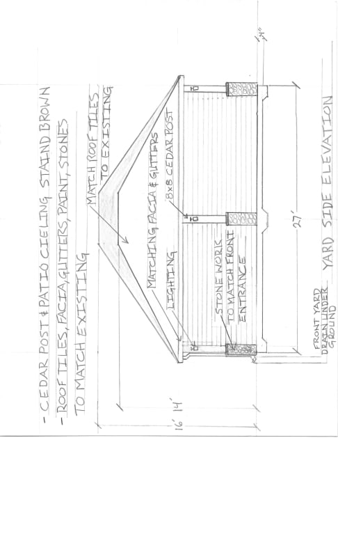

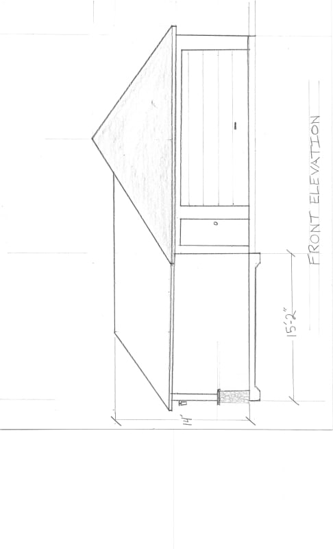

First time poster long time DIY'er, fellow engineer (IT Networking) looking for help.
Looking for advice on a covered patio build. It will attach to the detached garage that has a hip roof on it. I will add a ridge and carry the backside of the roof pitch all the way out over the new patio addition (add another hip roof basically. The patio is 22 feet long and will have (3) 8x8 cedar post. The post are 15 feet off the garage wall and about 11 ft apart. I am trying to determine the size of the beams I need. I will likely use multiple ply of 2x12 like a 4plyx2x12 for all my beams but I want know what if that is to much. I really want to get down to 2ply 2x10 cedar IF possible.
I have three 15 foot spans (post to garage). On Garage side I will sit on trimmer/jack studs under the garage sill plate. I am not planning on using a ledger board. What size beam for this?
Then I have the 22 foot span with a post in the middle. So I guess 2x 11ft spans. Again I was thinking 4plyx2x12 but want to use 2ply2x10 cedar again . Whats the recommended size beam here?
There will be a ridge 2x6 with 2x6 rafters and a composite shingle roof. I will also run some 2x6 joist for a cedar t&g ceiling between the beams. 12/8 pitch on the roof and I am in Texas where we do not get snow but have gotten some hurricane winds in the past.
I would love for the beams to be 2x10 instead of 2x12 if possible because it allows me to use cedar planks readily available at my Home Depot. Is this possible? Attached are some pictures to give an idea but the roof is drawn wrong. The new ridge will be as high as the existing and the back existing roof will be the same all the way across with no valley. Only one side will have a valley.

A couple notes, you keep referring to a 22ft span but your sketch shows a 27ft transverse span. Not sure where the 22ft comes from. You mention a ridge 2x6 with rafters. Is this a ridgeboard? Are your 2x6 joists going to be detailed and function as rafter ties? Otherwise, your perimeter beams will need to resist the spreading force of your rafters. Or you can change that ridgeboard to a ridgebeam. How are you going to resist the lateral load parallel to your (3) 8x8 posts? Currently, that is going to be flopping in the wind. In my area, we would pour an isolated concrete footing (NOT how you have it currently shown where it is supported off the edge of the thickened slab), place 12" or 16 square CMU block columns all the way up to the beams. Fasten the beams to the masonry columns with some Simpson embed column caps and your CMU provides the stiffness and resists the lateral load. You can always put veneer over the CMU to make it look nicer. I also don't like the way that you are proposing to tie back to the existing structure. You are going to be dumping a ton of load into the structure and foundation without having any real idea whether or not it can handle it. Cedar looks nice but is weaker than douglas fir. It works well for outdoor pavilions and pergolas since its decay resistant and you don't need to incise it. If you were to try and do the same thing with Doug Fir you would need to incise it which would automatically make it look horrible and no one would want it. Using T&G cedar for the ceiling is logical since it looks nice but doesn't make much sense for the beams since it's weaker and super expensive. I can touch more on this topic if you want but it involves treatment options and what is appropriate for your application and what is available in your area.
Let's assume your two outer beams support the roof loads and you take care of your spreading forces with rafter ties. Roof framing, plywood, asphalt shingles, roll paper, and cedar T&G ceiling weigh 19 psf. No snow loads considered. 20 psf Roof Live Load. Not considering Wind Loads (which is a considerable factor since you mentioned past hurricanes). Assuming dry conditions with temperature 100 - 120 degrees F.... A 6x18 Douglas Fir Beam would barely make it. Not a chance that 4 nested 2x12 cedar members would work. Your more likely scenario is to be using something like a 5.5 x 15 Glulam Beam. Or you could probably go with a 5.125" architectural grade glulam if looks is a big concern.
As you can see, these are pretty large members and is going to put a serious damper on your plan to just nest 2x members together. I am an avid (and I stress avid) DIY'er. I've personally built spiral staircases, outdoor redwood pavilions, decks, fences, reroofed my home, remodeled my entire house.... but this project is a pretty massive undertaking unless you know what you are doing. I know that you want to nest the 2x's because it's easier to handle but now that this plan won't work, just imagine trying to handle a 15ft long 5.5 x 15 beam. The size beams that I mentioned should probably make you realize that you could be at risk for seriously undersizing some members and having a disaster on your hands. I would definitely heed phamENG's advice and hire a local structural engineer who can economically size all of this for you. I definitely would not ignore the wind factor as this can get pretty significant.

Don't forget you need to figure out how to extend the portion over the original roof / garage where the loads increase.
There looks to be a flat roof portion as well.
My design by the structural engineer used a steel beam from the midpoint out to the far wall of the extension and had a V shaped support out to the end of the flat roof section. You don't have walls to support the side so that 15 ft span is taking all the roof weight if you don't add some sort of middle span from your central post back to the main house.
He used cross ties to hold the roof together and stop it all spreading out.
Definitely needs someone who knows what they are doing here, regardless of permits. If / when you want to sell you'll need to provide some data about the design and a sketch won't do - people will want calculations.
Wind uplift is different as well.
