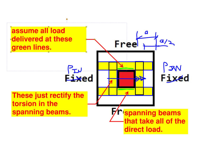

I would think there are a few ways this problem could be simplified. First suggestion is to cut the plate into four segments, along lines joining the corners (e.g, top left outer to top left inner). The top and bottom segments will be in bending, fixed at inner box edges? The side segments in twist, with equal gradients at the inner box. You can work out the bending and twisting stiffnesses and proportion the moment applied in the middle. Once proportioned, work out the stresses in the top and bottom segments. Food for thought!
I'd just discretize it like this unless there are 10,000 of these things or its an existing condition.

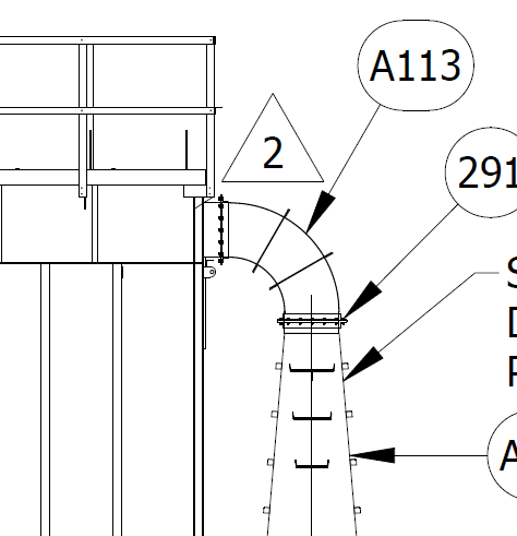

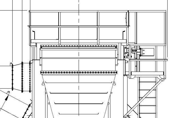

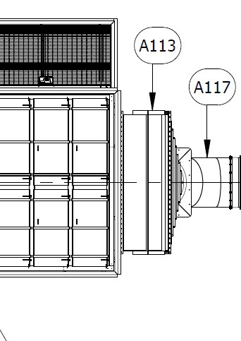

Thank you all for responding so quickly. I should have given you the actual problem I'm facing and not just how I simplified it. I have a bag house with ducting hanging off of it. The weight of the duct is ~600lbs and its COG from the wall of the BH is ~3ft. The hole for the outlet ducting is 18'' in height and 112'' in width. The plate from the hole to the supports and edges of the plate (fixed and free ends in my rough sketch) is 16'' on all sides.
The actual problem is that the previous engineer working on this job didn't add a flex connection between the ducting and the baghouse so the weight of the ducting will be supported by the wall of the BH. And the foundation has already been poured so I can't just move any part of the system to account for the flex connection. I need to determine if the stress from the ducting hanging on the BH could cause an issue, specifically if the BH needs to be strengthened around that connection. I'm going to add a flex at the bottom of A113 and the next duct and then rigidly support it so I wont have issues there, but I can't rigidly support A113 itself because of thermal expansion as the system starts up and is shut down. A113 is the item number for the duct in the pictures I've attached to this reply.
In my rough sketch Y is vertical, going up normal to ground.
Here are the images taken from GA drawings. A113 is the duct in question.

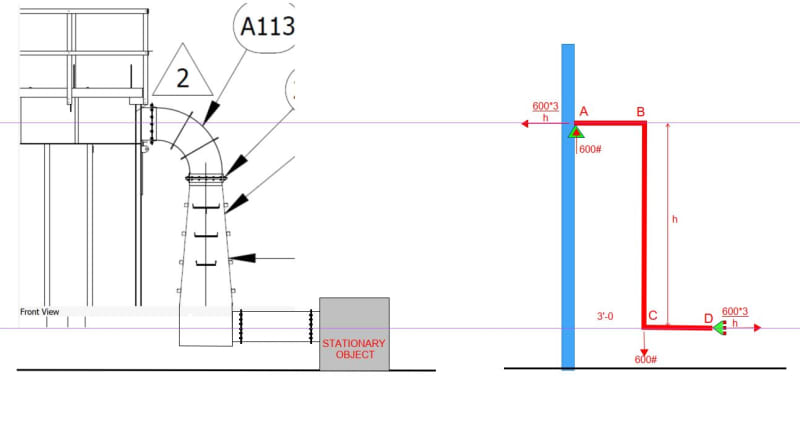

I'm not convinced that you have the correct static model. Your SIDE VIEW does not show what happens at the bottom of the duct. If the duct is supported (or could be supported) at the bottom, it is possible that the sheet metal support for A113 does not resist a moment. In other words, the joint at the wall could be a nominal connection which may act as a pin, possibly supporting a vertical load but no moment.
Please indicate the full SIDE VIEW all the way down to the floor.
Expanding on yesterday's comment, I believe the sketch at left represents the structure. The sketch at right shows a hinge at A and D, the applied load of 600#, and the reactions at A and vertical roller at D. Notice that there is no moment at point A, provided point D is prevented from moving horizontally and the duct ABCD can be considered a rigid element.
