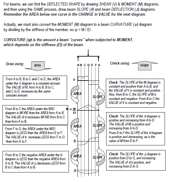

My memory of this is a bit fuzzy, but first integral of the M/EI diagram gets you slope, the integral of a slope diagram gets you deflection. Screenshot of my analysis course attached.
Jayrod12 is correct. Load the conjugate beam with the M/EI curve. Shear of the conjugate beam is the slope of the real beam. Moment of the conjugate beam is the deflection of the real beam.
A simple example:
Consider a beam with equal and opposite moment 'M' applied at each end (cylindrical bending). Moment diagram is constant M across the entire span. M/EI is also constant across the span. Shear at midspan of conjugate beam is zero which means that slope in the real beam is zero. Maximum moment at midspan of conjugate beam is (M/EI)L2/8 so maximum deflection in the real beam is (M/EI)L2/8.

I'm a bit puzzled why you find a problem calculating the shear and moment when you are happy integrating a curve, but a mathematical procedure that will do what you want is:
1. Assume zero slope at one end, and integrate the M/EI curve to find the slope curve.
2. Integrate the slope curve to find the deflection curve.
3. Rotate the deflection curve so that the deflection at end 2 is zero. This is the actual deflection curve (assuming a single span with no deflection at the ends).
This procedure is equivalent to the conjugate beam method.
