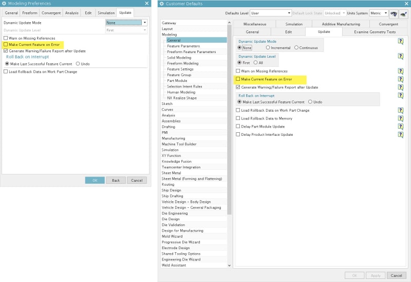

Feature is made current when it has an error.
flitch1969
Automotive
Jan 3, 2014
19
NX'ers
When i update my features it stops on features that have an error. i had this set to blow through the error an just give me a window when done but i cant seem to fins this switch again. please help?
Dave
It can be set in the modeling preferences or in customer defaults (see image below).
