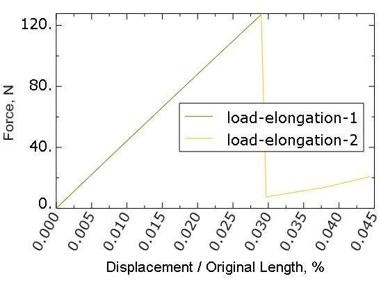

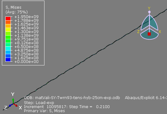

2. FEA on a 250mm model which is separated into standard (static) method and explicit method.
The STANDARD (static) part is good, but the explicit (dynamic) part is not.
[ul]
[li]The yarn shows a undulation after switching to Dynamic/Explicit method, attached fig 1

[li]The Load - Displacement/Original Length curve is not right compared to the experiment curve, attached fig 2
[/li]
