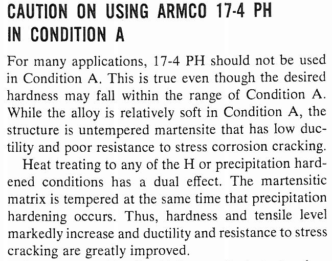

Assume zero. The A condition is highly variable (like strength and ductility changing by more than 2x) so any fatigue estimate could easily be off by an order of magnitude. The A condition has the lowest elongation and RA of any.
If you have an application where you want to use it in a low strength condition then select H1150-M.
P.E. Metallurgy
Thank you guys for the Answer.I read this today only. I hadn't received any notification of the replies.
Thank you EdStainless for detailed info.
Can you please tell me the source of this info? I want to read more.
