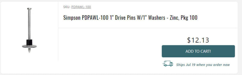

Try PAFs with washers? I've used them to attach plywood to hot rolled steel before when a nailer wasn't possible.

@dold - I think pafs, even with a washer, would blow apart cb but just a guess
I use PAFs for sheet steel to real steel/concrete or something like that. I'm afraid it would rip up a cement board, and a PAF that's not an X-U or something similar (like the ones for wood sill plates) would be too weak to penetrate a structural steel flange.
