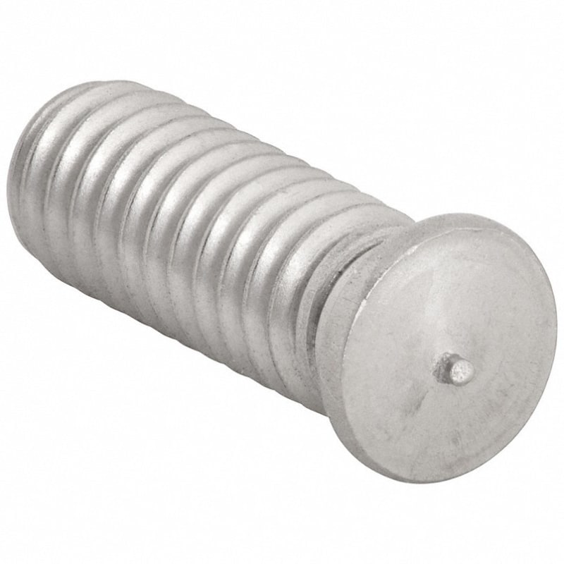

My first thought was welded, threaded studs. Little bit of fab shop work but time saver for the framers.
That's our standard way of detailing it.
My thought too. You could also do Nelson studs that are threaded and probably take care of it on-site:
I've done Nelson studs... put the lumber on top and smack with a hammer to mark the stud locations... works pretty well.
