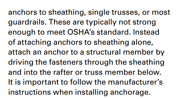

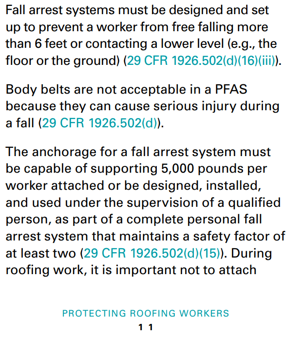

This sounds like they are purely shifting the problem to the truss manufacturer. Fall arrest are typically 5000 lbs point load at anchor, specialty systems I believe can have less in their ICC reports based on testing. I'm guessing this is how the project went...

While I say it's not possible to attach to wood trusses, I'm sure it's possible; but likely to increases costs significantly to make the connection. Additionally, does every truss need this? Typically you need to be able to tie off at many locations, think a long cable running length of building or a rod etc.. so that you cannot fall more than a few feet at any location.
I recommend pushing back to the EOR, but expecting you may need to work with the EOR on how many plies the truss are and making sure the truss can handle the loading.

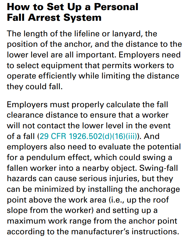

See OSHA 1926.502 attachment... (hopefully it worked... let me knoow if not)
+/- once every other year, I need to address a Fall Arrest "situation".
"ALL things considered" (in other words... to "Keep It Simple"... omitting more than we really need / want / decide to know or conclude)... to provide (more than reasonable) assurance of safety, provide the answer and get the job done...
Accompanied with an internet article, entitled "The Myth of the 5,000 lb. Anchor Point", in support of my own interpretion of OSHA 1926.502(d)(15) thru 1926.502(d)(16)(ii), I have "comfortably", with the aforementioned "assurance of safety", applied 1.8K to be the MAF = Maximum Arresting Force necessary to design to support.
FWIW... within the link by "LittleInch", the "theclimber" reply, although contrary to my derived / conclusive opinion, has doubled what OSHA (IMO) is directing. Despite "theclimber" stating being "familiar with OSHAs regs", was the "900 pounds" in OSHA 1926.502(d)(16)(i) overlooked? Am "I" treading on neglect thru my application of the "900 pounds"?

I encourage all to thoroughly review "OSHA 1910 Subpart I - Personal Protective Equipment" and "OSHA 1926 Subpart M - Fall Protection" as well as EVERYTHING else advised by Eng-Tips participants! It is topics such as this "Fall Protection" that really make Eng-Tips invaluable!

As the truss supplier, you need the loads from the EOR. This is improper delegation. I'd suspect the 5,000 is unrealistic to "spread" to multiple trusses, unless you have specific instructions from the EOR where they've vouched for their design being stiff enough to spread that load to multiple trusses.
Further, for these sort of forces, one would be well-advised to do some form of special inspection, via a third party (this is outside your control, however, from the sound of it).
The engineers who immediately start debating the load down from the maximum arresting force, if you ask me, are going outside the OSHA standard, while it may not fail and may save somebody from a fatal fall, the actual forces involved when they are underdesigned (my word) will probably damage the anchorage to the point it won't be safe for a re-use.
A wood truss does not typically want a 5,000 lb point load somehow wedged into it over a 4" x 4" area (face of the truss top chord).
You could potentially design for the 5,000 lb load on a truss top chord and then ship the truss back "early" to the EOR so they can design the actual guts of their connection. Cloud it and indicate "truss is designed for 5,000 lb reaction." Be quite clear that the EOR has to provide the connection TO the truss for that load. You could also indicate what duration of load was used for this element (I believe 2.0 for impact is not allowed for connections, but you aren't designing the connection, unless your truss plates somehow get involved), and the load case for the arresting force is another question. It would seem like it would most likely happen during "normal use" (i.e. minimal live load), or construction (so roof live load) and not during design snow events.... that might be wise to hold the EOR feet to the fire on the appropriate load cases. "This design is based on fall arrest force and roof live load applied simultaneously, and 1.6 (2.0?) duration of load, bottom chord live load has been omitted for this load case. EOR please confirm."

BSVBD - If OSHA requires a design load of 5,000# per person, that could be daunting. It's rare that one person works alone when framing a roof.
