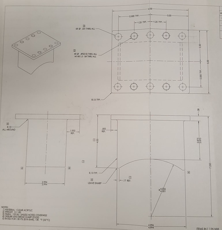

How would I go about finding the max torque that can be applied to 2 jack screws to free up a stuck acrylic plug without causing the flange on the plug to fail?
