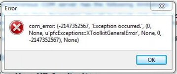

Also I am suddenly getting this error from my code it seems to be an issue with connecting to the COM service. View attachment 6353

Hello prcdslnc13,
Could you help me using the vb api with python? I tried but I get the "no module named IpfcAsyncConnection" error.
my code is as follows:
import win32com.client as win32
asyncconn = win32.gencache.EnsureDispatch("pfcls.pfcAsyncConnection")
conn = asyncconn.Connect(None,None,None,None)
session = conn.Session
mdlname = session.CurrentModel.FileName
print mdlname
Hello prcdslnc13
Could you help me with the connection to CREO using Python please?
I used the following Python code without success:
import sys
asyncconn = win32com.client.dynamic.Dispatch("pfcls.pfcAsyncConnection") # This line executes without problem...
conn = asyncconn.Connect(None,None,None,None) #The code crashes here saying there is no AsyncConnection method
The CREO API works without problem with VB.net, and Perl, so I think the API settings are good.
I need help please!!! Someone!!
