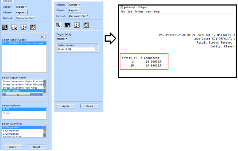

Hello all,
I'm working on a project where I need to extract the stress value at each node of the structure.
If some one can show me how I do that i'll be thankful.
If I understand correctly, you want to extract them to text file. See attached picture.
