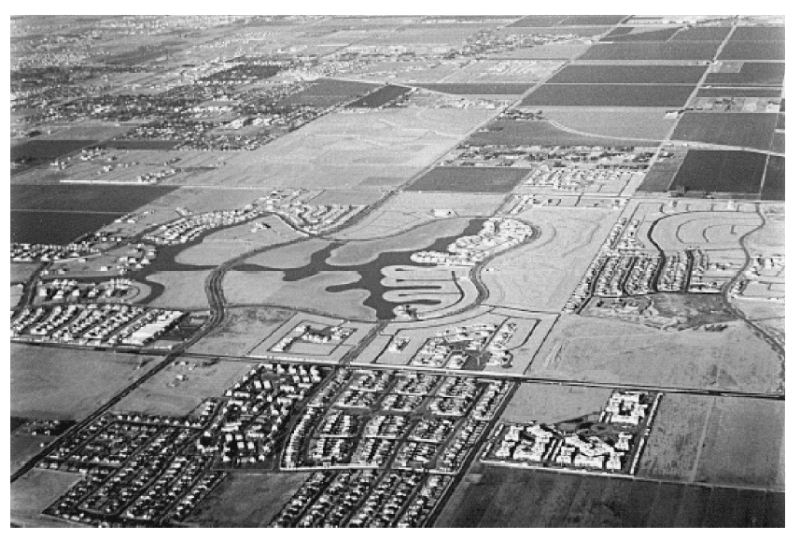

Just wondering, how many of you would apply Exposure C to all buildings in the following picture (even in the middle of the subdivisions)??
It would depend on which surface roughness predominates within the 1500'. It looks like Exposure B might be appropriate in the upper left corner of the photo.
DaveAtkins

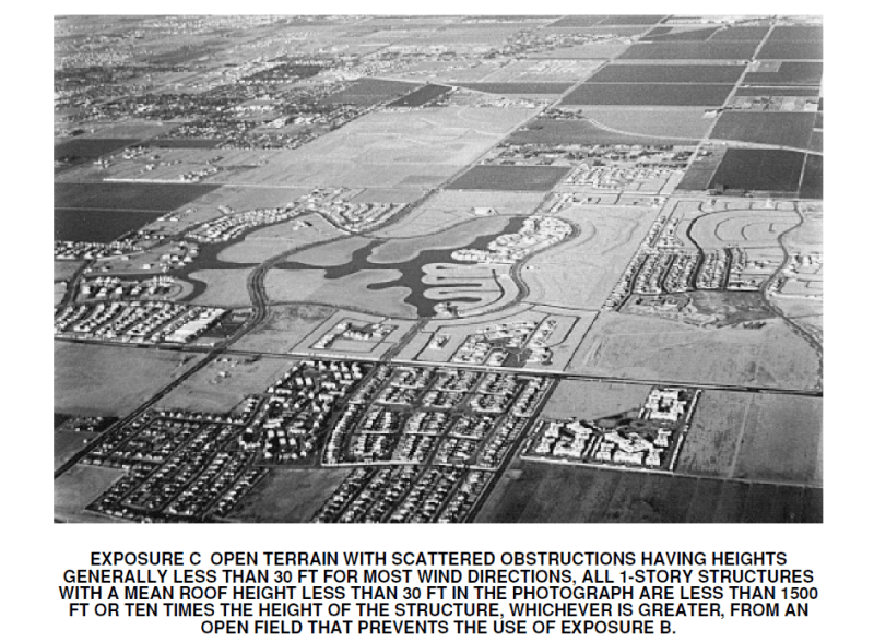

This topic is very interesting for me as I have been trying to teach engineers over the years that many times the buildings they are designing as Exposure B are actually Exposure C. The most recent version of ASCE7 Commentary has finally made it easier to defend my argument that open areas force projects to be C many times, and the size of open areas doesn't have to be all that large, a small parking lot can sometimes do it depending on it's location in reference to the building.
As for forests, I have always wondered the same thing, but was taught that you design for what is there at the present as you cannot predict the future use of land. I believe that the assumption is that they are going to only cut it down to develop it. If you live in a region where forest lands are used for Timber, I would be more likely to design as C knowing there is a good change it will be cut down in the future. Luckily I live in such an area where B is rare, except for the few isolated locations in the city where there are no "open areas" around, so we don't have to spend much time picking between the two classifications.
@ Dave - I agree that the foreground in the photo should be exposure C with the possibility that the background may have areas of B, however I routinely run across areas such as this and see designers using predominantly Exposure B. Truss designers, PEMB engineers almost always use Exposure B and will argue with EOR/Owner that anything more stringent is wasting the owner's money (undercutting the EOR in the process in many cases).
I also see other designers acting as EOR who are much quicker than I am to give a site Exposure B to sites that boarder field or open areas justified based on common practice of the past. ASCE 7 is pretty explicit on the issue, in both the code and the commentary, yet the practice still prevails.
While we have not seen widespread wind-related issues in my area in recent years, I feel like designers should be a bit more careful with using correct wind exposure, especially now that wind speeds have been lowered for a large majority of the interior of the country (ASCE7-16).
I meant to mention by the way that the image above is directly from the ASCE-7 commentary for Exposure C (based on the caption, all buildings in the photo are Exposure C).

I posted the photo without the caption intact because I feel like there are plenty of engineers that would give exposure B to the buildings in the foreground and it sounds like it is common practice in many areas. In the past I think many engineers justify that the exposure category is likely to become B soon into the life of the structure as the area develops. My point is that with the drop in wind speed we are loosing some built in "fluff" in wind loads and I feel like some extra diligence in exposure category is merited for wind design post ASCE7-16.
Here is the photo, caption included.
