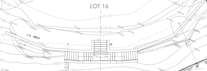

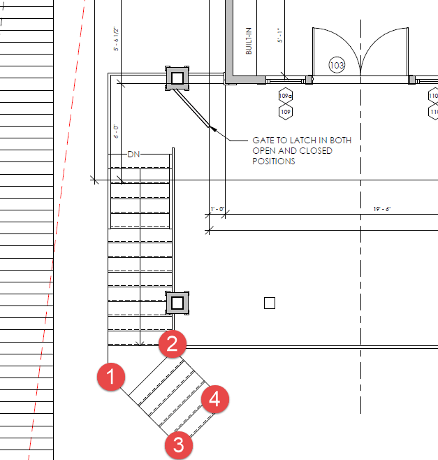

I have a residential project where I will have to use drilled piers because of the expansive soil. For the deck, I will make sure that each post will sit on a drilled pier. How about the stringer support for the stairs to the deck, do you think it is necessary to have drilled piers to support the bend of the stairs (wood framed) and the very bottom of the stringers? Or perhaps we can have stringer connections that are able to rotate? Or shall I go ahead and add 4 more drilled piers?
This project also has a retaining wall that is not connected to the house. Do you think it is OK to just do a typical cantilevered retaining wall without using any drilled pier? We are trying to minimize the # of drilled piers. I am thinking if the soil does expand, the whole retaining wall will move with it.
