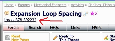

Copy and paste this instead of the URL, for a MUCH clearer link.
thread378-392232
thread378-197902
