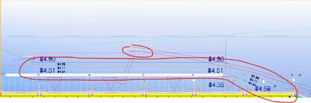

Hey everyone!
So I'm designing a low concrete stairs on grade (total height of about 320 mm) with 3 risers. It's relatively long though, more than 20 m. Can you give me some advice on what the spacing of expansion joints should be?
It's located in Estonia. So frost heave is a question as well. Below is a plan view and a section from the architectural model.
Do you mean expansion joint, construction joint or control/contraction joint ?
I wouldn't have thought an expansion joint would be necessary. Control joints on a 1:2 ration for the width of the slab. and wherever it needs separation to other structures.
Heave can only be mitigated with joints, not controlled by it - that is down to the sub-base and anti-heave precautions.
Sorry, I don't know the proper word for it in English. I mean a joint to control cracks better to shrinkage or expansion.
