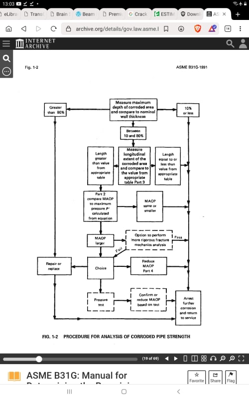

Dear All,
we found corrosion in our pipeline, hence we performed ILI-MFI and found ERF less than 1 as per ASME B31G.
When I referred ASME B31G, I couldn't find ESTIMATED REPAIR FACTOR(ERF) criteria.
Please clarify in which clause ERF (ERF less than 1 or greater than 1)criteria is specified in ASME B31G.
ERF > 1 indicates repair is required, or MAOP must be reduced.

A quick GOOGLE shows that ERF is actually just what Integrity Engineers use to show whether a defect is acceptable to ASME B31G or not.
SO it is simply a ratio number, I presume of the MAOP calculated by 31G divided by the current MAOP of the pipeline.
Hence why it is not in B31G itself, it has just become a useful number to show in a report.
You get the same in stress analysis reports with an easily scanned number to show when an item is above the max allowed stress or not.
This from a Penspen document.
4 The ‘ERF’ or ‘Estimated Repair Factor’ is a popular method for assessing the significance of a defect.
The ERF calculation is another way of expressing an ASME B31G assessment [6]
. If the ERF is less
than one the defect is acceptable to ASME B31G. If the ERF is greater than one the defect is not

I have one more question, can you please clear it?
Is it correct, instead calculating the ERF, can I go with ASME B31G,clause 3 TABLES OF ALLOWABLE LENGTH OF CORROSION
The following are applicable to Tables 3-1 through 3-12M:
, to make decision to accept and reject corrosion.
