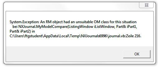

Hello,
I have following error (see in a picture below) while debugging Model Compare function in both NX 10 & 11 Environment. Can anyone help me to solve this error and I didn't understand what the meaning of "an RM Object has an unsuitable OM class."
Or anyone suggests me if there is any mistake in code.

According to the API docs, you should probably be using the .ModelCompare3 method. Try .ModelCompare3 and see if you get the same error.
