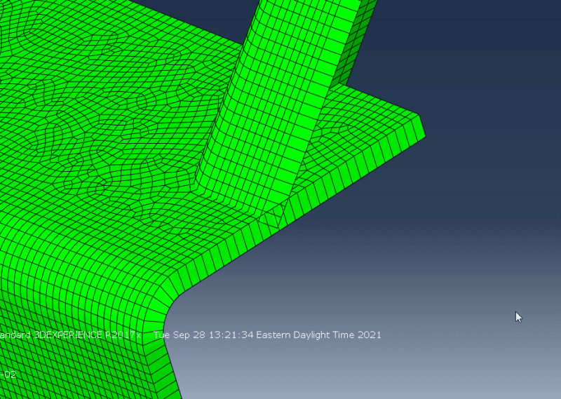

I have a error that is driving me mad. I have created a model of an HSS connection using shell mesh. For some reason where two HSS meet eachother I am getting an error that
1) Mesh is distorted
2) There are zero area elements
No matter how much I refine the mesh the problem doesn't go away. What could be causing this? The red element in the below picture is the only element with the second warning and the Abaqus model is attached.

No tie constraint there but it's almost certainly caused by overlapping shells (enable shell thickness visualization to see that) and general contact.

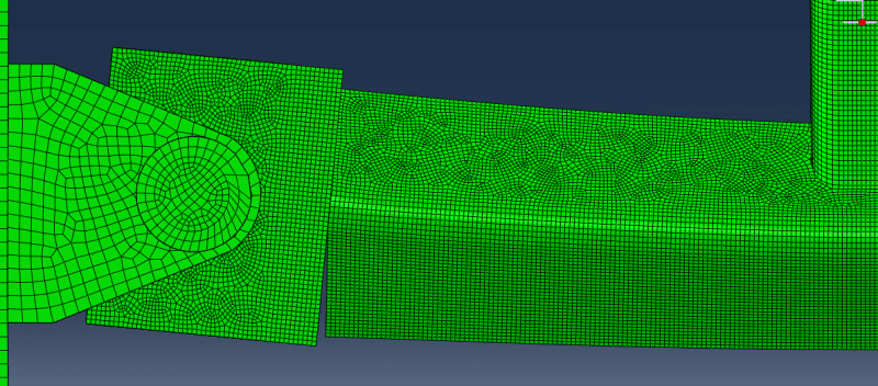

FEA way, thanks for the reply! How do you reckon I would have gotten overlapping shells in the model? Both HSS are one part and I "automatically" meshed the whole piece. I've re-meshed and changed seeds multiple time with no success. I did remove the part from the general contact pairs and now the model runs, but I have a new interesting problem! I defined a shell-to-solid coupling where the HSS meets the plate and the bottom of the HSS is separating from the plate. I refined the mesh on the plate thinking nodes weren't in the search distance and it still separates.

The shells do appear to be overlapping when thickness is turned on, but isn't that expected with the definition of mid-surfaces? Would that imply that shells cannot be connected at an angle like this?

This connection is tricky because edge of the shell part is V-shaped and it's hard to align it with solid part's mesh. Try partitioning the surface of the solid part in such a way that both meshes fit together more closely.
Overlap of shell elements might be a problem in general contact because shell thickness is considered by contact algorithm and self contact might be detected here. Offset functionality may help you model this region. Another way would be to use solid elements for this connection and attach them to shells representing the remaining part of this structure with aforementioned shell-to-solid coupling.
Wow, that is really surprising that mid-surface shells cannot be connected at an angle like this. It seems like it would be a pretty simple connection!

I would check to see if any of your interactions have the "adjust slave initial position" option turned on. I have had the issue where this option was inadvertently turned on, and the adjustment caused some elements to collapse, resulting in the same error you're getting.
Indeed, that’s the most common reason for negative volume elements and thus I checked this first in the model attached by OP. However, in this case, there’s no tie constraint in the area with distorted elements and the problem is clearly caused by the overlap of shells and the way it’s treated by the general contact algorithm.
