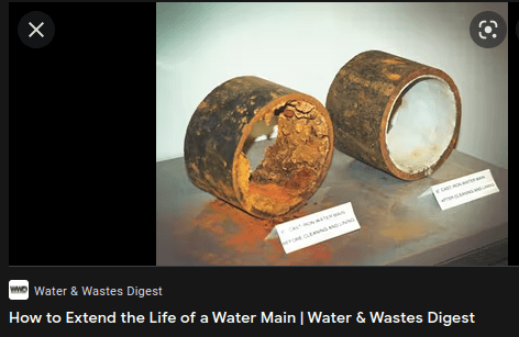

You should inspect the galvanized pipe as it has been in service a while. If the galvanizing has has ANY pinholes you may have a full on case of internal Tuberculation, The picture blow shows one of the alternatives to replacement, before and after.
