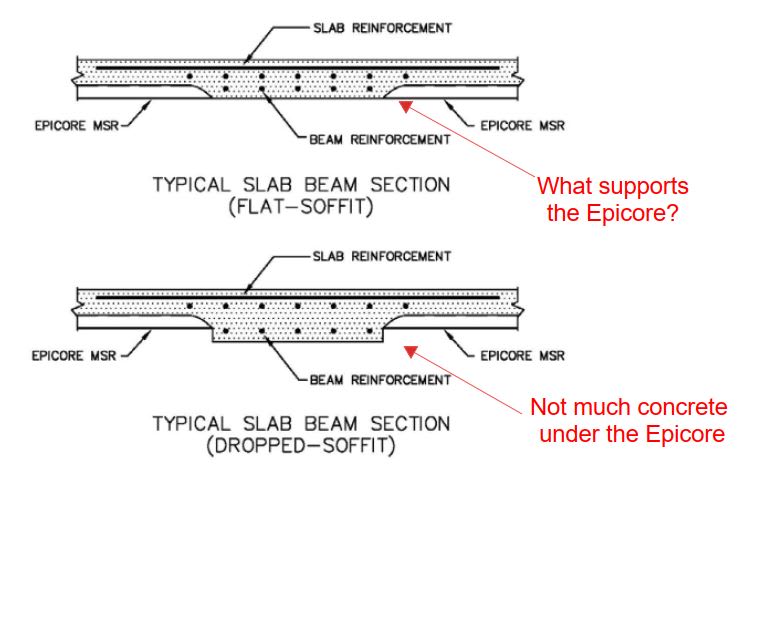

I'm wondering if anyone has encountered a condition as detailed in the attached image. I have a epicor (dovetail) deck that comes in to the face of a concrete beam - this will obviously need to be a monolithic pour. Other than designing the connection for shear and moment along the length of the pour, are there any additional, extenuating circumstances here? I'm thinking if connection between the epicore slab and the concrete beam is rigid, then there are no additional torsional considerations - or no? Any input greatly appreciated.

I have not used Epicore deck, but it seems clear that the deck would normally be supported on a steel beam, joist, steel angle or concrete corbel; some type of flat surface with provision for attaching it.
Your section shows no support under the deck; it just butts up to a concrete beam. Perhaps a continuous angle or concrete corbel could be provided on the beam to support the deck, but it is a rather unusual detail.

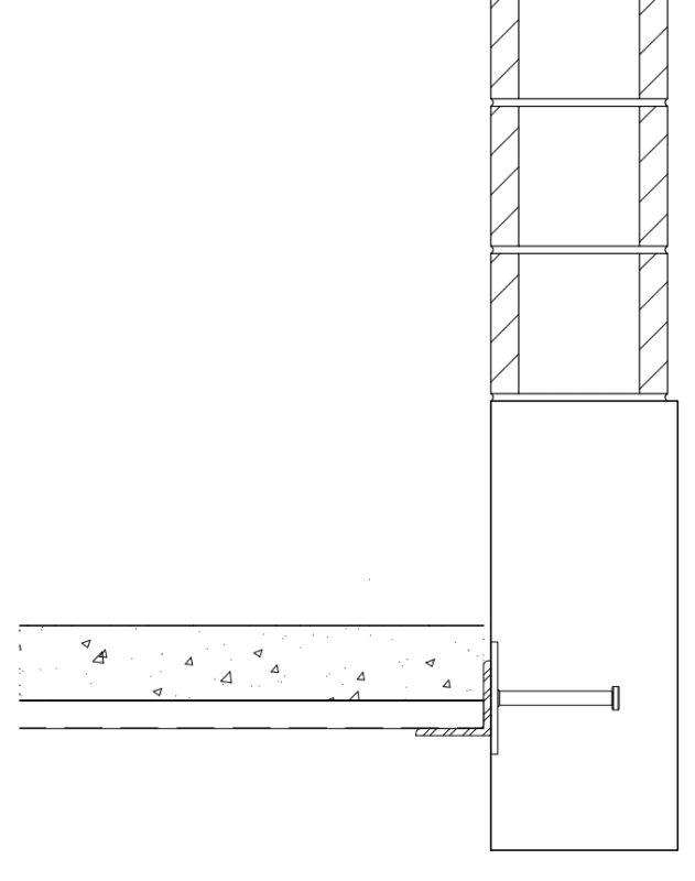

...little plates cast into the face of the beam secured with headed studs. A ledger angle, maybe L3x3x1/4 welded to this to support the deck on... I just noticed, but for composite floor deck the ribs are narrow and are spaced apart to save concrete. This appears to be the other.

With an upturned beam and not too much concrete below the deck, the left hand detail is unacceptable. A properly reinforced corbel is a better detail. There is some torsion to consider, but it is not likely to be a problem.
Something like the attached... likely the least costly... needs welder trade on site, but a lot cheaper for formwork and reinforcing and a lot faster?

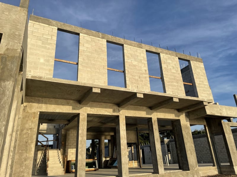

I guess where I'm having a hard time understanding why we're talking about alternate details is because Epicore was specifically designed to eliminate these alternate bearing conditions. That was how it was explained to me a few years ago by the prez of a shell company we deal with. He was selling it as an alternative to hollowcore because hollowcore has to be installed after the walls are poured. The benefit to Epicore is that its all one pour. Walls and floor get poured together then you build the next level of walls and floor on top of it and so on.
I've included a few pictures to show you what I mean. The epicore and tie beam are poured together. There is no bearing angle, no corbel.

Maybe that's a "better detail" but I don't know how you can say its not acceptable if it's designed for it. They do it with slab beams.
I do not believe that a 35mm unreinforced projection of unknown depth is a reliable support for an unknown reaction. For a downturned beam or a wall, it may be okay, but we are talking about an upturned beam without specifying the height of concrete below the deck. Concrete has been known to break off. Furthermore, it is impossible to inspect after pouring.
It might look good, but it is not a good detail in my opinion.
