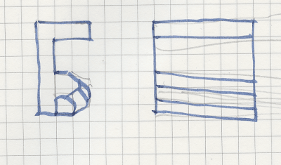

An internal thread 5/32 position is modified LMC and has MAJOR note beneath. How to read and understand this geometrical call out?
I've seen a straight thread modified at MMC for gaging purposes, but never one modified at LMC.
Is it correct?
