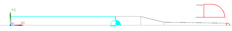

Hi, how should I define a simple 10mm endmill?
it has ~ 20mm flute length,
then ~ 10mm undergrinding at 9.2mm diameter
finally ~ 40mm shank.
When I try it as 70mm 'length' and 20mm 'flute length',
how is the 50mm gray part treated? Is it a shank? Or a neck?
When I set tool neck clearance 0, it collides with the part ...
Fraisa endmill

You didn't mention what version you are on. For tools without a neck parameter I believe the gray segment is treated as a shank. I'm currently using version 12 and and testing 1872 series (1892). I thought in the new version that neck definition was added to 5,7 and 10-parameter tools but I just checked and it appears not. However there are neck diameters for other tools such as barrel, taper and tangent barrel, and spherical. I have also run into the clearance issue you describe; in 3D Dynamic Verify will return false errors which is super annoying to say the least. I might get around to calling GTAC this week so if I find out more information I will post it here.

Sorry, it is 1872. I am changing powermill to NX, and I try to find the way to do what we had in powermill. Thanks!
I recently spoke with support and they confirmed there is not a neck diameter parameter for 5,7 and 10 parameter tools. Why this hasn't been incorporated as of yet is beyond me. I get collision errors in 3D verify frequently which in reality is simply zero clearance even though my tools physically have neck clearance but it's still annoying.
One workaround is to set the SD value smaller than the tool diameter and forego having a shoulder defined, if you don't have to collision check the shoulder. This should effectively give you the proper neck definition. If you need an undersized neck and a shoulder then you'll have to wait for an enhancement. For my application I require the shoulder for collision checking and put up with erroneous 3D Verify errors. Also, I believe you can specify the length and the flute length the same to have the neck start at the top of the flutes.

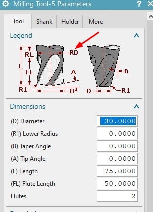

In 1899 version is prepared new parameter RD for diameter after flute section. But isnt possible to define yet.

In old versions some users have defined a neck by using holder definition but this is not a good solution. I think we have to wait for it to be enabled in 1899.

I totally agree and basic tool definition is long overdue. I thought Siemens would have implemented reduced shank definition for simple, commonly used tools before implementing it on others. At least it is starting to roll out in 1899. As dzupfrg pointed out the dialog is showing the definition albeit the parameter fields are not live as of yet. Hopefully they will be enabled in the next monthly update or perhaps there is an env variable to turn it on.
