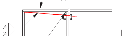

Im following AISC design guide 39 end plate design, and for those that have it, Im following example 5.2-1
Im trying to calc my column web shear rupture strength.
Now, for the beam shear rupture strength, it calcs out teh beam flange strength and you check it against your shear. Makes sense.
For the Column web shear rupture strength, they seem to be checking the strength required against the value used to check the beam flange to the beam end plate. That ends up being the max calculated tension at the end plate, or 60% of the beam flange tensile strength. I think I get using that for the end plate and weld to end plate, but once that load is in the column, cant I calculate my shear rupture against the actual tension from the end plate, not the beam to end plate max values? Are they just doing that to be conservative and have the column be as strong as the beam flange/end plate strength. i.e. not have the column be the weak link?
I hope I explained that right.
