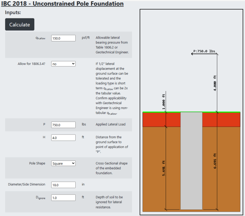

You mentioned not having geotech values..What are you using for your allowable lateral bearing pressure? Are you taking advantage of the 2x increase allowed for flagpoles (can the equipment tolerate 1/2in of movement at the ground surface?) Are you increasing the allowable lateral bearing pressure with depth as allowed by the table?
OK thanks for the gut check.
Strucbells, I am not taking the increase for the 1/2" movement and I am not increasing the lateral BP with depth as I don't have the geotech reports. I am considering 150 pcf per the Presumptive Load Bearing Values table in IBC.
Makes sense why your required embedment is so large. Not taking the 1/2" movement increase is fine based on your understanding of the equipment.
Not increasing the lateral bearing with depth is needlessly conservative in my opinion, it is explicitly allowed by the code for these presumptive (conservative) values. Physically, the soil will be more confined as you get deeper and therefore you get more allowable bearing pressure as you get deeper. As long as you don't have a trench/big grade change/etc. nearby, I don't see a reason to not take this into account. Should fix your issues.
Sorry maybe I am misunderstanding... S1 in the IBC formula is the lateral bearing pressure based on 1/3 the depth of embedment... but the required embedment depth changes based on the S1 value used. I used the 150 psf/ft per the table, but how do you determine the required depth if the values change based on the depth?
it is an iterative process, when your done the d,calculated by the IBC formula should match the d used to determine S1.

Gotcha. So if I am reading this correctly... you can increase the lateral resistance by the tabular value for every additional foot of depth and for an unconstrained condition, I am basing the S1 value on 1/3 the embedment. So let's say, as an example, my required embedment is 6 ft in an unconstrained condition and I am assuming a tabular lateral resistance value of 150 psf/ft. 1/3 the embedment would be 6/3 = 2 ft. Therefore my lateral resistance values would be 150 psf/ft for the first "layer" and then (150 + 150=) 300 psf/ft for the second "layer"? Or would it be 150 psf for the first layer and 150 psf for the second layer?

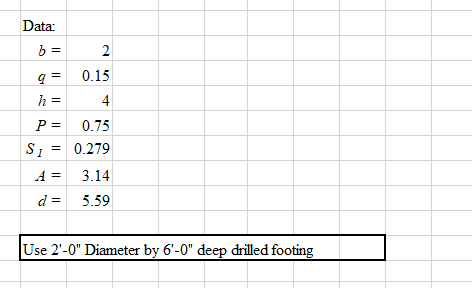

Here's my spreadsheet output for a 2' diameter pier with a 750# load at 4' above grade.
[pre]
Mo : 3750.0000 ft-lbs Effective Moment at the start of embedment.
b : 2.1213 ft Diameter or Diagonal dimension of pier.
S1 : 284.5656 psf Allowable lateral soil-bearing pressure based on a depth of one-third the depth of embedment, however d not over 12 feet for purpose of computing lateral pressure.
A : 2.9073 = 2.34 P /(S1 b)
D : 5.6913 ft Embedment Depth from IBC 2018 - Eq. 18-1
Dtotal : 6.6913 ft Total Embedment = D + Dignore
[/pre]

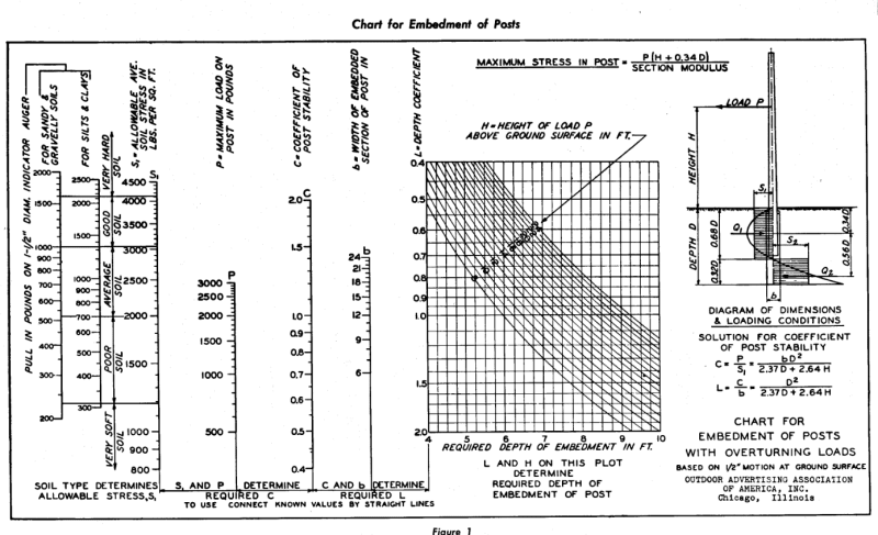

The IBC equation is a modified version of the nomograph developed by P.C. Routledge, if you can find a copy of Pole Building Design by Donald Patterson it provides some additional information:
