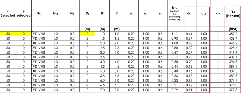

@LeonhardEuler: See the excerpt from Bowles below where the concerned expressions have been highlighted.

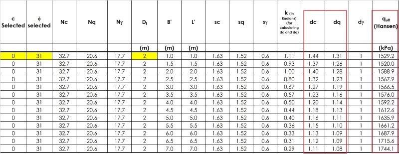

If we keep the depth fixed and increase the width, these factors appear to keep on decreasing since D/B ratio would decrease (see sample calculations in the image below).
In an attempt to find a pattern here, I have made a few more trials for which the results are shared here.

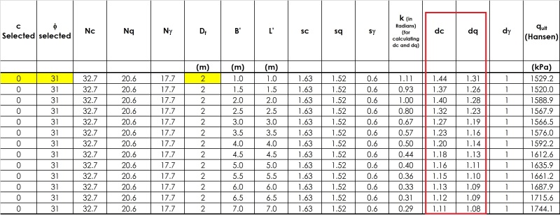

Trial-1
Sand
phi=31
c=0
Df=2m
Result: Qult (more or less) increases with foundation width

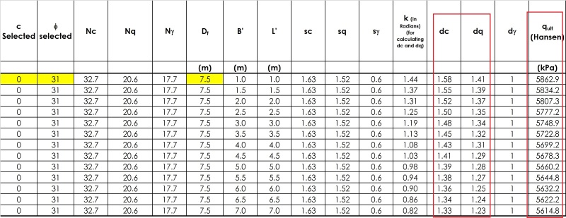

Trial-2
Sand
phi=31
c=0
Df=7.5m
Result: Qult decreases with foundation width
Trial-3
Clay
phi=0
c=50kPa
Df=2m

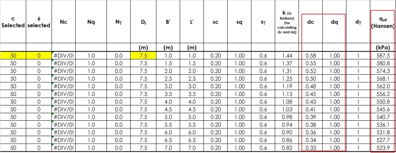

Trial-4
Clay
phi=0
c=50kPa
Df=7.5m
So a conclusion I have reached from the above trials is that,
- Qult for sands decreases with width as long as D/B>1, and for D/B<=1, it increases with width.
- Qult for clays decreases with width irrespective of D/B ratio.
Seems like a flaw in the method, to me.
