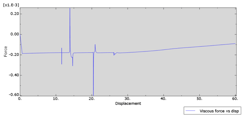

I have a dual layered structure. When a general ILD(Indentation force deflection) test is done on the part, a smooth FS curve is expected as per test data. But inorder to achive convergence, I have used control cards. Does that affect the FS curve?
*Step, name=Step-1, nlgeom=YES, unsymm=YES
*Static, stabilize=0.0008
What could be primary causes the FS curve to be wavy ? what can be done to remove this unwanted waviness, is there some control card in input deck which can prevent this wavy FS curve ? It is not the material card because the material card is a smooth curve similar to test data.

I plotted the viscous force vs displacement , load vs displacement graphs. Looks like the VF vs disp graph is way softer than the FS curve. But the behavior of VF vs disp graph is very strange. Is this genuine behavior ? Also ALLIE seems very stiff compared to ALLSD,ALLCD,ALLVD so I think the dissipation percentage will be way less than 2%. Is there anything that I am missing? How to avoid the artificial damping ?
Note that these sawtooth-like parts of the load-displacement curve appear at the same time as peaks of the viscous force-displacement curve. These are the moments when artificial damping is used to help the model converge. But still the viscous forces are very low when compared with overall forces in the model. And, since you say that the ALLSD/ALLIE ratio is also small, then I wouldn't worry about these artifacts. Of course it would be best to make the model converge without any stabilization but this might be difficult in many cases.
Try to understand what the solver is trying to stabilize i.e., what sorts of instabilities are occurring in the model at those time points when viscous stabilization is kicking in. For instance, are the load/BCs changing, is the contact status changing, is the material softening, is the structure buckling, etc.?
