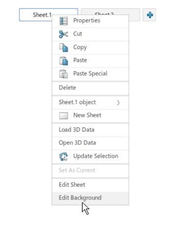

I have imported a 2D drawing from V5 to 3Dexperience and had content in the sheet background.
I can't find the "Edit/Sheet Background" function in 3DX CATIA Drafting workbench.
Does anybody know where this has disappeared to in 3DX, or if it has been removed/replaced by something else?
Eric N.
Ahhh that's where it is.
Thanks a lot!
