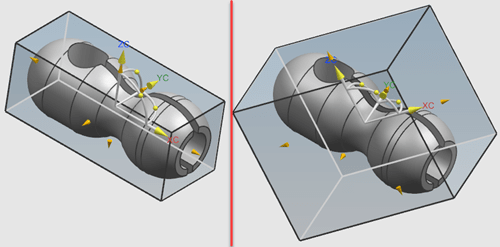

I want to write a journal that creates a NonAlignedMinimumBox and then gets the lenght of it's edges.
How to get the edgeLength when creating a NonAlignedMinimumBox BoundedBlock ?

You do know that there is a button that creates a bounding box ?
search for "Bounding body".
It will present the edge lengths in real time when you rotate the coordinate system.
Regards, Tomas
Thanks Tomas
Yes, I know there is the function, but i want to create a journal that writes the edge lenghts into attributes(independent of a Csys).
Using the toolingBoxBuilder1.XValue.Value don't get the real values.
Regards, Javi
You need a csys definition. ( or use the Absolute Csys.) - The Csys controls the directions of the edges,- the orientation of the block.
Regards,
Tomas
My goal is not to have to define a Csys.
In interactive mode, the MW_TOOLS_BOX shows the dimensions of the created block on screen, even in non-aligned mode.
I want to avoid having to establish a Csys piece by piece.
Javier
without the csys definition you will most likely be using the Absolute Csys.
Regards,
Tomas
But in this case the measurements might not be accurate if the block is not aligned with the
Absolute Csys.
I think there is no solution...Thanks anyway Tomas
Regards,
Javier
Finally I've achieved a solution that works...
The strategy that I have used is to create the "non aligned" bounding box , then create a Csys on a face of that bounded box, and finally get the dimensions using the obtained Csys.
