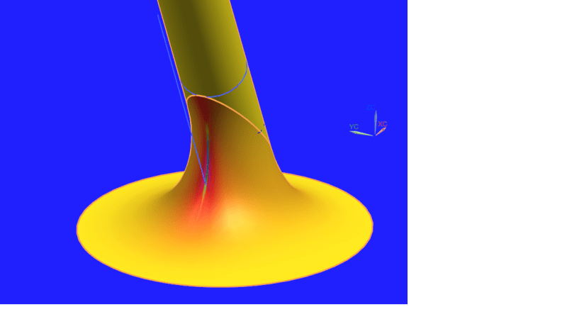

I have some fairly simple geometry. Using NX12, a cylinder is angled at 45 degrees relative to a flat plate, and I would like to put an edge blend around the intersection of the cylinder and the plate. This works at very small radius values, but as the radius increases, there appears to be a "pinch" in the edge blend, and eventually, a self intersection and the blend cannot be created. Eventually, I would like to put a conical blend around this intersection, but it is failing similarly.
Does anyone know why this happens? I try to imagine a ball physically rolling around an inclined cylindrical rod, and I believe it would maintain 2 point contact everywhere. Perhaps it has to do with how blends are calculated in 3D?

In the edge blend settings, if you turn on "remove self intersections" and "patch areas of complex geometry", you'll still get a pinched area, but it will avoid the self intersection error.
Try a face blend with the "swept disc" section type (pick the edge at the intersection of the cylinder and plate as the spine curve). This might give better results than the edge blend for the same radius value.

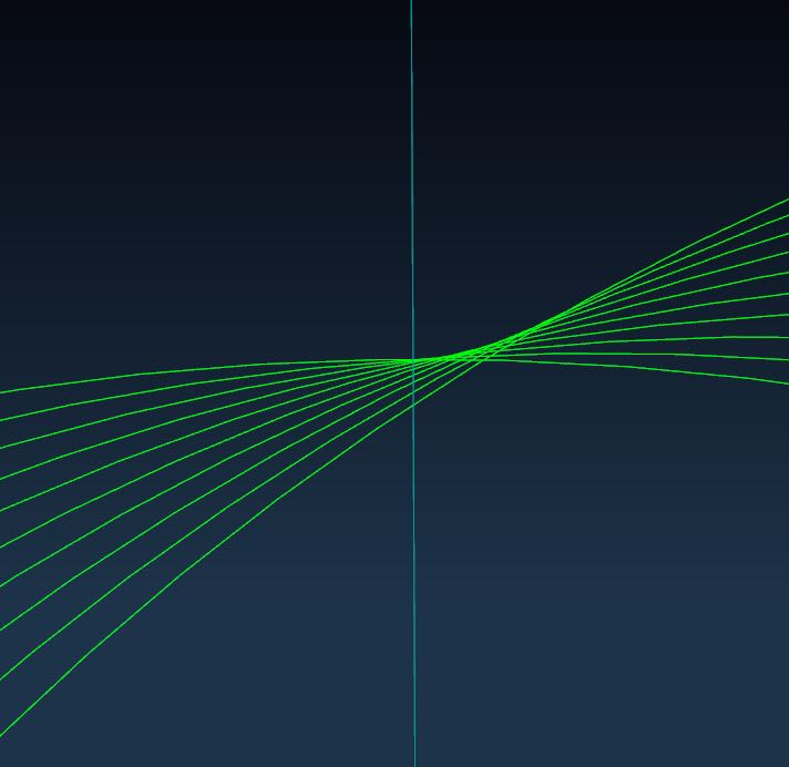

The geometry definition in this case is actually pretty tricky, as you say, its a rolling ball definition, but that also means that the tangent section between the two contact points will rotate about the imaginary axis that the two points define because the plane of the circle is defined by the surface normal in each point.
In the left example in the picture, i have created "iso parametric curves" ; these curves will replicate the tangent-sections of that rolling ball. Each single curve should closely replicate a circle. ( The few i selected are true circles.)
Notice how these section-planes "turn inwards towards each other" where you get that wrinkle, the tangent sections overlap .

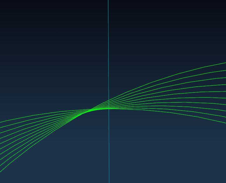

On the right, i created a face blend instead of edge blend, this time "a swept disc", here i can control the section plane using a "spine curve", all circle sections are normal to the spine. The spine curve used in this example is the original sketch circle. any closed curve can be used for this.
Here the wrinkle doesn't occur.
you can also define a conic section instead of circular using the swept disc option.
