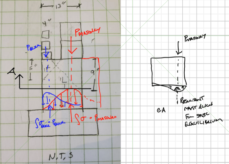

When is it okay to ignore eccentric loads on strip footings with stem walls. I am told at the office to include overturning, but it seems way too conservative and unnecessary.
Here is a scenario, I have a footing with a 13" wide stem wall. See pic below. Hypothetically, if that stem wall is deeper then 9" there should be no eccentric load on the actual strip footing. Thus the strip will see a force on the center, and the bearing force is evenly distributed underneath the strip. No need to check overturning(ignoring wind load and other horizontal loads)
Now, this is an industrial building with a very large load on the masonry wall above the stem wall. The brick goes only 8 feet high. I can see if there was no stem wall, and the masonry and brick go all the way down to the strip footing, there will definitely be an overturning force. but not in this case.
What do you guys think?
I feel that logic to be a serious violation of statics. Your assumptions regarding load spread to not change the center of action of the original force. If you draw an FBD, this should be self evident.
As to when I would ignore the eccentricy: never. I may not go into great detail but I would give it one of the following considerations at minimum:
1) Is the load comfortably within the kern?
2) Is there a restraining element at the top, or sides, of the stem walls that can rectify that eccentricity?
If I drew a FBD, my eccentric force will lean very heavily to the masonry side. Say we did that and got an eccentric point force at the top of the stem wall. However, considering that the loads spread 30-45 degrees on each side of that top point. Shouldn't there be a certain depth at the bottom of the stem wall that the load force is distributed throughout the bottom width of the stem? whether it be 9" deep or 30" deep or greater? then the strip itself sees a centric point load(not including the stem wall weight)
Or when creating the FBD do we just take that load at the top of footing and drop it down to the bottom of the stem without including effects of distribution?

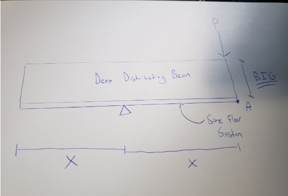

With these kinds of things I find it fun to do some wonky hypotheticals / desk examples if I can.
Lets take a look at the picture below. What do you envision happening at point A?
Now lets make that bottom grade (instead of a teeter totter) and ask the same question.
But before you answer first lets see what happens when you press down on the edge of a card on your desk.
What do you think now?

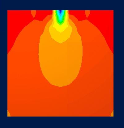

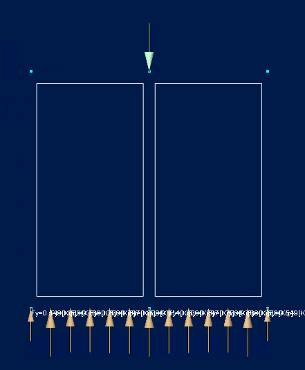

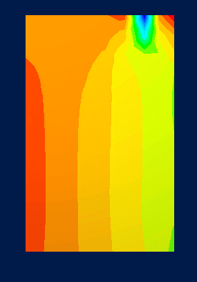

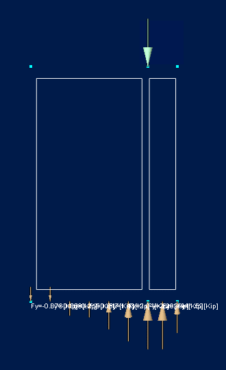

No sir. Internal stress distributions, whatever they may be, should not affect the overall FBD of an element assumed to be rigid.
That one, all day long.

It doesn't work that way. As KootK says, that violates statics.
The footing will apply an uneven bearing stress if the load on the footing is eccentric. It has to for equilibrium to occur.
I generally check peak bearing stress, or check that the wall (or slab) can rectify the eccentricity.
